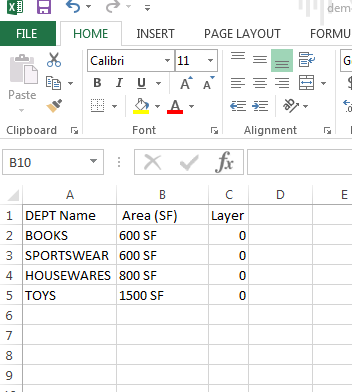

OK - here is the Autocad drawing and a snapshot of the the kind of table I need.
The drawing is a quick architectural layout of a store plan.
Basically I have labeled store department areas  surrounded with polylines in a drawing. I would like to be able to sect them and have the put int an Excel chart.
I thought my problem was the same as miguelmlas - but now I realize i needed the areas to be in square feet (SF) because my drawings are in architectural units.
Message 23 of 180
devitg
Please change it
area   (vlax-curve-getarea e)
to
area  ( / (vlax-curve-getarea e) (* 12 12))
as the area is given in Inch , divide it by 12 times 12 or 144

Thank you pbejse and devitg!
Exactly what I need for my project.
Now I am going to see if I can figure out how to round the square foot numbers obtained in the table to be rounded off to the nearest foot.
Message 26 of 180
I used one of Lee Mac's lisp functions - rounding to the nearest integer - and set the precision to "0" and I got the results I needed.
Thanks again!
