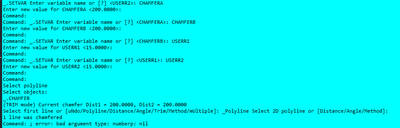

SilentStrike24
Hi @CADaSchtroumpf,
Yes, i did. Please see below picture.
Apparently, if I change variables "USERR1"/"USERR2" or not,  it still asks for a polyline and the result is the same.

SilentStrike24
Hi @CADaSchtroumpf,
Solved the problem with that .dll. Meaning i reinstalled the software 🙄
I got rid of that error, but there's another one. Please see below picture.
And consequently, it keeps going with chamfer/polyline, even if i change variables.

Message 20 of 25
CADaSchtroumpf
I was able to reproduce the same error; when you are not in the WCS.
Try with the attached file, I think to have fixed the code.
