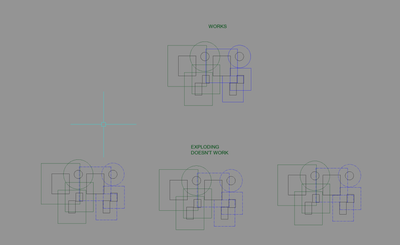

I've got a subroutine that for the most part does what I want it to do (unioning together the green layer and unioning together the blue layer), but then I want to explode each resulting entity into its original polylines rather than the region that results from the union command. The subroutine does all this for just a single grouping (not in the sense of the GROUP command), but when I select multiple groupings it doesn't explode.

No ... do you read the Autodesk documentation? HERE.
Message 9 of 11
ВeekeeCZ
@Jonathan_Bell82GXG wrote:
Still nothing. Is there something about REGIONs that make this more difficult?
Yes. You need to explore how those commands work. Mainly whether creates a new entity or just changes the original. Use (entsel) for that. UNION does not create a new entity!
Also, EXPLODE is tricky when comes to regions. It creates a polyline only if it is one object. Else create regions.
Your routine fixed.
