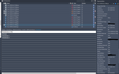

It would be helpful to be able to see in Vault whether the selected part or assembly contains multiple model states.
A listing of the model state names would be a great relief.
If the properties are also displayed when clicking on the respective model state, it would be much easier to handle the files in Vault.
Can possibly look like this:
1 Comment
RogerdeSmidt
Yes please, this is crucial for gaining the functionality of Model States, otherwise part numbers and custom property fields for Model States, apart from the Primary, are completely unsearchable in Vault. Also need to see the active model state of parts or assemblies when they appears in the "Where Used" or "Uses" tree.
