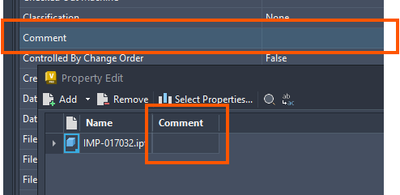

It would be great to have a possibility to edit and/or add only comment without physical file change.
Currently "Comment" property cannot be editted, because it is "Read-Only".
Also only "Comment" cannot be added (when checking-in for example), because there is no "physical" change on the file, therefor ignores the added comment.

But why would be create a "custom" property, if system property already exists...
We would like to have comments on same property, not on multiple different propeties.

That is correct, but even if we use check-in again (without physical file change) it ignores the comment, that why idea was presented.
As for file comment property, it is a workaround, but it is better for users to use 1 property and that is Vault comment property.
