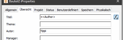

For example, the property "Title" requires a value and is filled in Inventor using the fx rule. After pressing the save button the Data Standard not display this property and the save button (OK) is not released.
The required value is missing for the Data Standard if an fx rule is set.
Please allow these two great features to be used together.
1. Screenshot - property with fx rule

Maybe allow the property to be shown, but as read-only.
Then mark the property with an (fx) as read-only because of an fx rule inside the property?!
