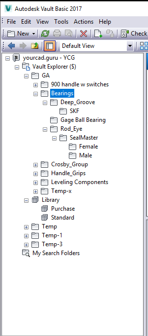

Scenario:
You're setting up a Vault, or putting items into the Vault via company standards (location, paths, etc)
You have standard purchase parts, or standard company Parts/Assemblies.
Let's use the Bearings as an example:

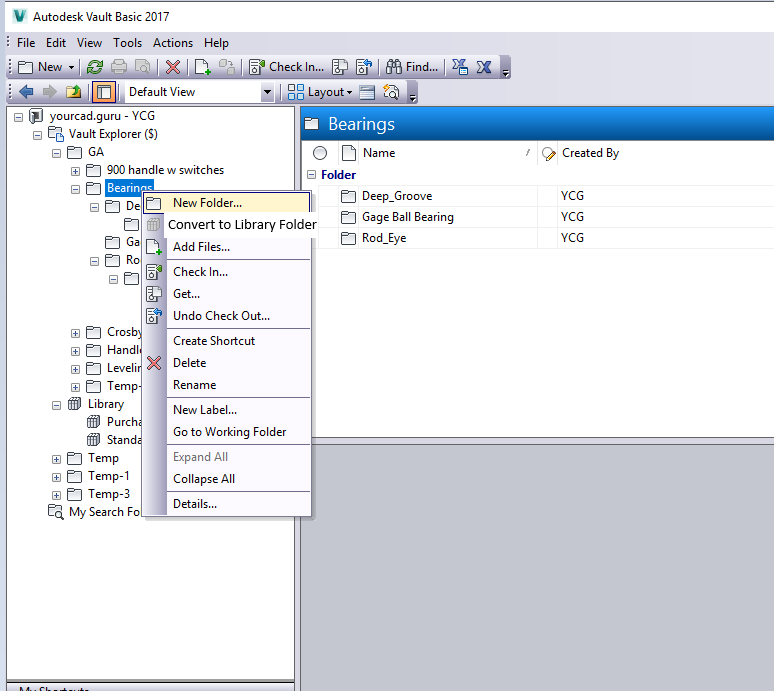

So I'm asking these bearings, and I want to have them in the supplier folder as well.  If you try and move it to the library you can't.
It would be great if you RMB on it and you have an option to : Convert to Library Folder and move it to where you want it in the Library folder.
So for me I would put this folder Bearing/Deep Groove/SKF in the Purchase folder.
