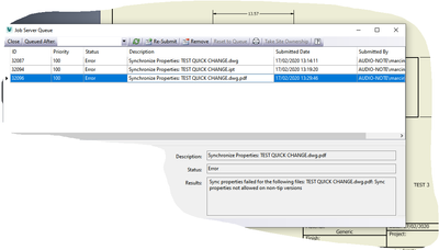

Hi!
I am having problems with pdf of dwg. When I revert released file to quick change and then back to released I can't get vault to update PDF. I have set it in lifecycle( vault settings, behaviors, lifecycles) under flexible release process and changed transition quick-change - released( in transitions it is set to update view and pdf). No change. What makes me wonder is that PDF is in released state and does not have quick change state.
Any ideas?

Marcin.Szklarek
As you see there is some problem I cannot trace.

smilinger
  1. You are not supposed to change the state of the pdf file.
  2. pdf files are not supposed to have quick change state.
  3. pdf files are supposed in the Design Representation category.

Marcin.Szklarek
I did exactly waht you suggest before.
Procedure:
Create ipt.
create dwg.
Release both.
Initialise Job processor to create PDF.
Put ipt and dwg in quick-change status.
Change dwg ( additional annotation)
Change the state from quick change to released.
Initialise Job processor.
The error from post one comes on and no changes in  PDF.

smilinger
The third error in your screenshot looks like triggered by incorrectly change state of pdf files. Do you get all these errors with the same message?
Another thing to consider: do you have same revision scheme for you dwg and pdf? If one is letter based and the other is number then it cause error.
