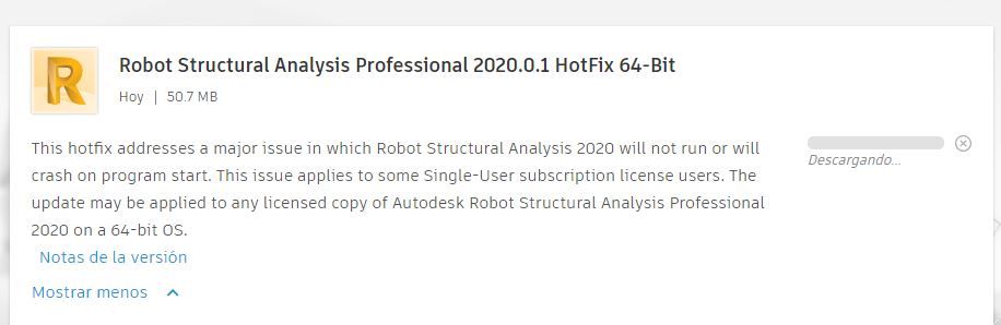

Message 10 of 23
aagalan
It seems to be fixed.
Message 11 of 23
okapawal
We have just released RSA 2020.0.1 Hot Fix 1  which addresses this isssue.
It is available through Autodesk Desktop Application and Autodesk Accounts.
This hotfix addresses a major issue in which Robot Structural Analysis 2020 will not run or will crash on program start. This issue applies to some Single-User subscription license users.
Please find more details in the attached Readme file.

Message 13 of 23
My RSA2020 its all ok now after installing "Robot Structural Analysis Professional 2020.0.1 HotFix 64-Bit "
Message 14 of 23

Message 17 of 23
I cannot find the hotfix under the list of product and update.
I have already logged in to my account.
Can you please help.
Message 18 of 23
okapawal
When you go to your Account and find Robot Structural Analysis product in AEC collection, unfold the product information and click Updates & Add-Ons, you should see all the Update listed.   See the screenshot
