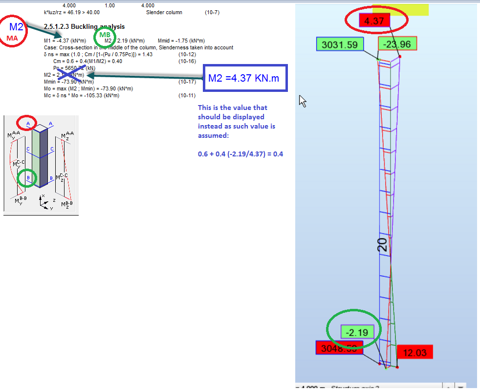

However, I would like to draw your attention that the value of (M2) in the note should adopt the largest calculated moment occurring anywhere along the member (ACI318 -10.10.6.4) otherwise the correction factor calculation (Cm) will be not correct… (Please take a look to the attached capture 005).
Concerning my second inquiry, what do you mean by saying that (in the member required reinforcement the force is taken from the verification point.)?

Dear Refaat,
Thank you for pointing our attention to this part of the calculation note. It seems that it needs some changes however M2 is calculated as per code requirements:
It is taken from one of the 3 points indicated on the picture above (A, B or C).

@Artur.Kosakowski wrote:
Dear Refaat,
Corrected in RSA 2017 SP2.
