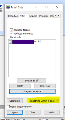

Select that panel and open it in the new window or click right mouse button and select Display for selection from context menu.

Is it also possible to examine the diagram analysis for only the one panel?
Yes Diagram analysis is presented for selected panels.
The integral/average values are impacted greatly by the other panels, unfortunately.
Use smoothing within a panel (or no smoothing)  to reduce that effect.

Try to select required panel (foundation) before Diagram analysis generation.

Well that was simple ....sorted. Thanks Krzysztof!
