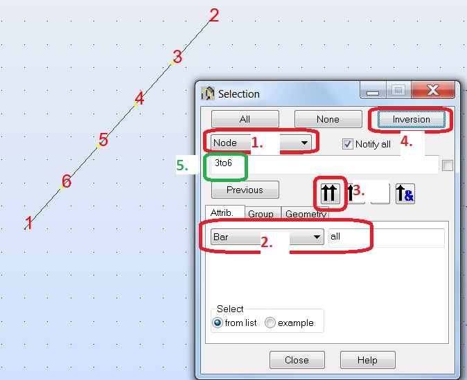

I have a question regarding nodes.
1) Is there a way to select only nodes that are on bars, but not the start point or end point. I would like to get rid of them. Nodes that have only one adjoining member.
And what's the difference between adjoining members and adjoining elements
2) Can I generate nodes at intersections of bars without dividing the bars for the whole structure? As using the Intersection command but without bar division.
Thank you in advance!

1)Just drag the cursor box over the nodes you want to delete and press "delete".  As long as you dont actually select the bar, the bar won't be deleted.
2)See pic

Yes, what you're saying is correct. But there are two problems here:
1) Dividing bars it's not needed at equal distances. This is not such a big problem because I can use the Divide by Plane option.
2) The big problem is what will I do if I have a bigger structure.
Here's an example:
In TOP view:
I have 30 vertical bars (Y direction). And another 10 bars that should be horizontal but after importing I found some of them a bit rotated (about 3 degrees angle from horizontal X direction). Probably due to some poor snaps in AutoCAD.
I deleted the bad horizontal bars, but the nodes from intersections remain. I want to select all of them and delete them. Preferably with a selection filter. - This is problem 1.
Secondly I will draw the 10 horizontal bars (in the correct position) and would like Robot to generate nodes at the intersections with the vertical bars. - Problem 2.
If they are not on any bar (disjointed \ separated) just run calculations and they should be reported as Isolated Nodes, then  select them by group $NODISOL and remove. Or just only run Verification to detect some of them or add new bars and run Detailed Correction to line = bar or plane.
If it is not the case please make screen capture or send sample.
   - add nodes manually snaping to these points
   - calculation nodes can generated automatically at these points due to these settings
