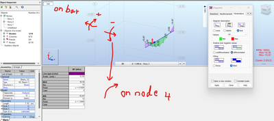

"You have to check balance of nodal moments in all bars connected to each beam 9 ends."
Moments balance check (in global plane Zy) in node 4 for bars 9, 2, 20, 12 (moments balance should give about 0.5* 1.5 )
Moments balance check (in global plane ZY) in node 2 for bars 1, 9, 11, 19 (moments balance should give about another 0.5* 1.5 )
bar 9 Mx : -3.97
bar 2 Mz: -12.17
bar 20 Mz: 8.53
bar 12 My:-15.92
How it comes to 0.5*1.5?
Message 23 of 88
Krzysztof_Wasik
Autodesk Support
Autodesk Support
Hi @HoshangMustafa
Moments have different direction
the same on other beam 9 end
2*0.76=1.52 which gives reasonable precision

When balance in node is verified moments direction in respect to node (not to moment sign in bar) should be be considered. Positive bending moment can result in transferring moment to columns in opposite direction when we regard opposite end of the beam.
Example
When we consider node 4, we can presented moments direction in the following way.
For verification you should take into account difference in Mz in common node of bars 20 and 2  Depending on direction set as positive (in respect to verified node) it is
Mc= (8.53 -(-12.17))=20.7
or
Mc=(-12.17-8.53)=-20.7
Moments in remaining beams.
Mx in 9 and also My in 11 and 12,  acts in opposite direction than Mc, so moments from those members should be added to Mc with opposite sign.
Verification from post 23 is correct.

Based on the link attached in post 28, if the directions of moments drawn in your last picture are for bars (not node 4), then direction of My-bar12 is incorrect.
I applied the sign convention of the link, it seems the directions on the bars as:
beams
bar 9: clockwise
bar 12: counterclockwise
difference= 19.94
columns
bar 2: counterclockwise
bar 20: clockwise
difference= 20.7
20.7-19.94= 0.76
Still not clear why subtract beam moments, subtract column moments, and then subtract those differences.

I think you should think it over. I look at it in the following way.
I can simulate loads from slab  as three bending moment, then I can simulate column as rigid support.
Then moment transferred by column can be presented as reaction in rigid support.
Slab is on the node right side  - so all moments applied to column from loaded slab are clockwise
Reaction should balance applied forces so its direction (moment transferred by column) is counterclockwise
You missed correct direction of moment transferred to node from beam 12 in post 31
It is clockwise in respect to regarded node, since the following situation occurs
This load on beam gives the following moment distribution in the column
Forces distribution can be simulated in the following way
Krzysztof Wasik

In post 31 you have written that moment My from beam 12 acts counterclockwise. When we check moment balance in node 4, this moment (My from beam 12) is applied to node 4 in clockwise direction.
ad2
A. Moments applied to the node 4 from beam 12 (My), beam 9 (Mx), and also missing moment part 0.76,  acting clockwise (in respect to node 4).
B. Since in statically stable structure sum of bending moments in each node, in each plane  is 0, then moments from point A. are balanced by Mz moment difference in column part (difference between column part below node 4 and column part above node 4). This moment difference (equivalent moment in column) acts counterclockwise.
C.  Sum of moments from point A (acting clockwise) and moments from point 2 (acting counterclockwise) gives 0 as expected for statically stable structure.
If anything remains not clear for you, or in your opinion, moments summation in node 4 should be different, please let me know. I would appreciate if you present your version of moments summation, then we can discuss it.

I understand that for moment summation in node 4, you set positive moment sign for moments acting in plane ZY as acting clockwise.
For that sign convention
MX from beam 6 ; M(6)= -3.97
My from beam 12; M(12)=-15.97
for that sign convention total moment from beam 6 and beam 12 applied to node 4
M(6)+M(12)= -19.97
Krzysztof Wasik
