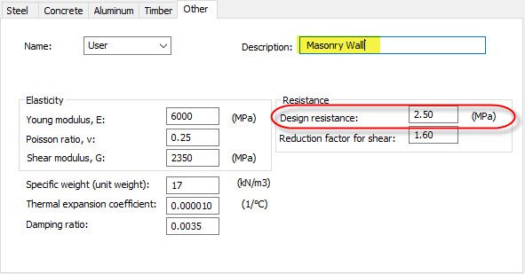

Refaat
in reply to: Artur.Kosakowski
Dear Artur
Greetings
1. Could you find out if I have defined correctly the brick walls as panels have only (compression stiffness) (transfer the slab load to the foundation) or not?
(Please see the capture)
2. Is correct to use the linear release at the boundary of brick walls to prevent any moment transferring between (slab& columns) and brick walls? If so, how do I overcome the instability message (type 1)?
(Please resend the rtd. File after correction)
3. Also, is correct to use a linear support instead of bar (lintel) to avoid any tensile strength in the part of brick wall above this lintel or you have another suggestion ?

Artur.Kosakowski
in reply to: Refaat
Dear Refaat,
I'm afraid that modelling a structure like yours in Robot is difficult. The instability is due to both vertical edges of wall in the corner they meet are released. Perhaps a better choice would be to separate both walls from a column and connect them (if needed) with short bars instead?
I don't think that the lintels can be modeled as supports.
I'd say the better approach would be to use the load take down approach which used to be available in CBS but is not part of Robot.

Refaat
Dear Artur
Thank you for your answer
Actually, I look forward to model concrete structure which its RC beams rested on the masonry walls (Bearing walls) as long as (No transferring moment from RC beam to the masonry wall) and the walls confined with RC columns.
So, the interaction between the RC beams and masonry walls leads to reduce the RC beam size as well the mount of reinforcement for these beams
While as the RC columns increase the horizontal and vertical capacity of these masonry walls.
However, the interaction between the RC members (beams& columns) is very importance in this type of structure.
Please, take a look to the attached (capture and file) to see if I modelled the structure correctly or not?
 Specially, the masonry walls and panel calculation model.

Artur.Kosakowski
in reply to: Refaat
Dear Rafaat,
I'm sorry but I find it difficult to tell you this is right or wrong as shell type surface elements as available in Robot are not intended to model masonry behavior. You can see this looking at the bending moment in beams which is zero as the entire load is transferred to the wall below. Perhaps you could consider modelling the linear releases with elasticity for vertical direction and do the same for the horizontal direction for links among the columns and the walls.
Dear Artur
Greetings
Thank you for your helpful answer.  I shall have been faster to response.
As you see in the first attached capture. I have tried to keep the required interaction between the frame elements (beam & columns) with the masonry wall by blocking (Uy) once and using the linear release with elasticity as you suggested in another once.
. At the same time I need the masonry wall act as purely membrane element in both direction (x&y). So, I reduced the stiffness coefficients as in the second attached capture.
In both tries still there are slight moments and shears values in the wall. (Third capture)
  • May I conclude that the shell element doesn’t represent the real modelling of membrane elements even with stiffness reduction and using the linear release?
  • Could I consider what I did the best way to model the masonry wall with RC frame in RSA? Or you have another suggestion.
  • Shall I use detailed membrane forces or complex membrane forces in order to compare the results with required design resistance (forth capture)?
  • In order to avoid any tension in the part over the lintel shall I use very stiff member? If so, what is the properties of this element?
Note : rtd. file is attached
Thanks a lot
Refaat

Artur.Kosakowski
in reply to: Refaat
Dear Refaat,
Correct. They are not design to behave as masonry.
I'm sorry but I don't have any additional ideas about modelling this type of walls in Robot in addition to these I already posted and I don't think I'm able to make a better model than yours. The only thing I'd consider is to model a walls without openings and lintels and 'taking care' of them designing a wall separately (e.g. in some calculator) based on reduced forces obtained from Robot.
