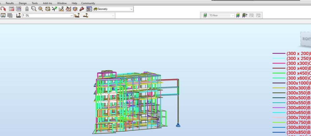

Djokaboris
Hi Sir @Simau
Many thanks for your answers and recommendation. Just from including the real size of beams and columns but Robot freezes when the calculation is run.

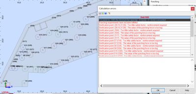

Djokaboris
Hi Sir @Simau
Many thanks for the time spent on the file, but because of the errors displayed there's no FEM results.
how to solve the freezing problem, if i may ask?

Stephane.kapetanovic
hi @Djokaboris
https://www.autodesk.com/support/technical/article/caas/sfdcarticles/sfdcarticles/ROBOT-Error-1470-r...
Best Regards

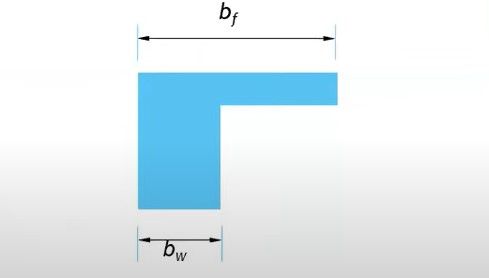

Thanks for your help and answers. Please is there a way of having this section in Robot RC beam design GUI ??

you've already asked the question here, I don't have the answer but you should try the fourth with a slab on one side only.
https://forums.autodesk.com/t5/robot-structural-analysis-forum/design-of-an-rc-l-beam/td-p/12973446
