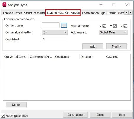

what is the deference btween these two disgard density in robot
 how should i use them if i include building mass in conversion would i have to check both or what is the right process

Hi @yahyasyd190MQUXY
If you have a load case with only SW you may let this box unchecked  then Robot will automatically convert SW to mass.
If you have SW mixed with other dead loads then you must tick the box and convert to mass these dead loads by yourself

Simau
The 2 pictures are completly independant.
The 1st one is about an equivalente force method which doesn't need to run a modal calculation first, so Robot ask you if you want or not to disregard the density.
The 2nd one is about a modal calculation which is followed by a seismic calculation.

yahyasyd190MQUXY
But last question
Does the equivalent method take the mass from the conversion?
Message 10 of 11
Simau
@yahyasyd190MQUXY
Not automaticly
You must convert load cases acting in seismic case by your self. Except Selfweight if you let "Disregard density" box unchecked.
