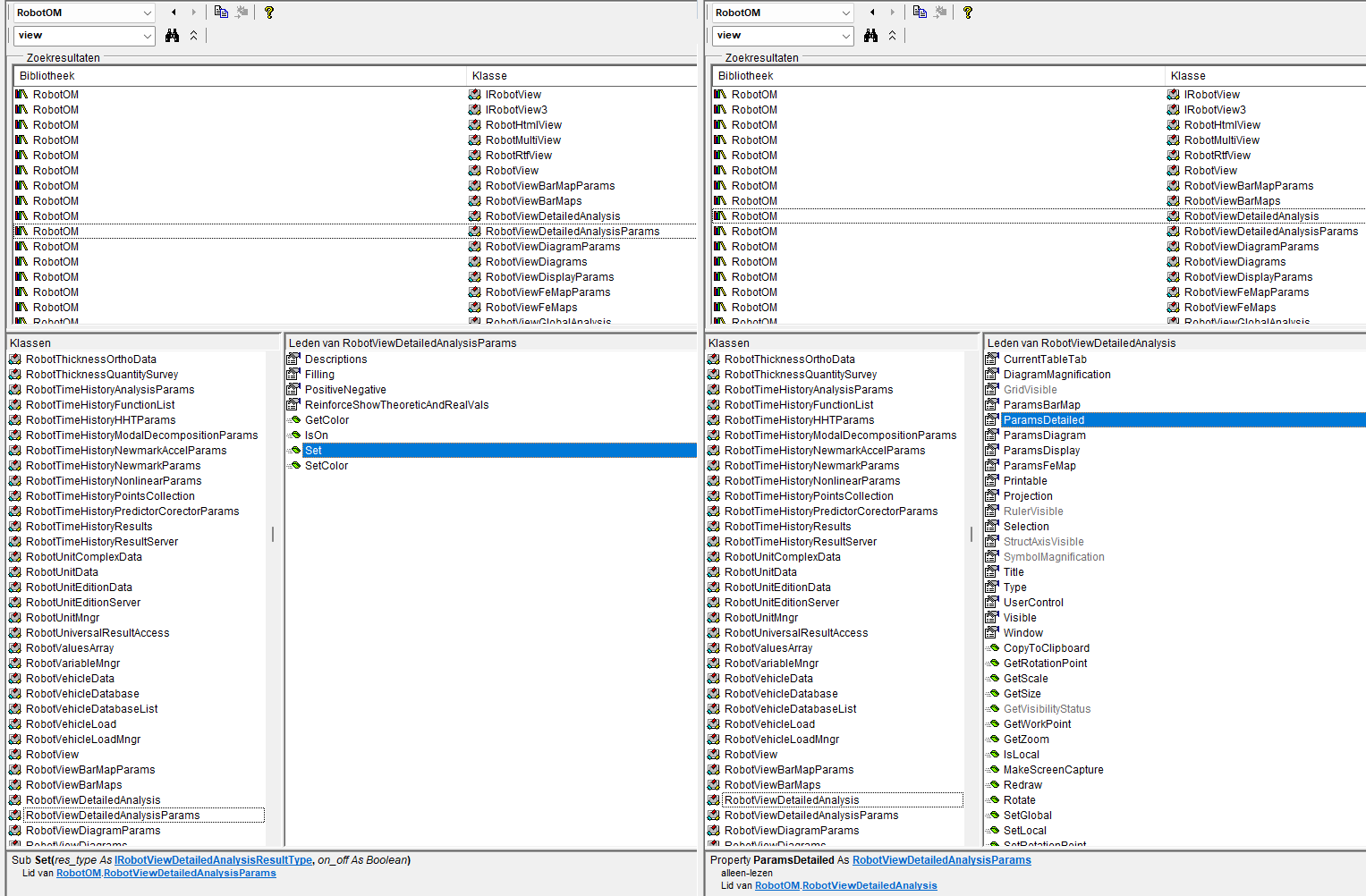

I am currently writing some automation (in VB.NET but should be almost identical to VBA) for Robot Structural Analysis 2024. The goal is to export images of structures and their deformation, but I can't seem to find the correct command and syntax to set the diagram description (nodal displacement component) UX, UY, UZ or U(total). I also can't find the right command that does what the "Normalize"-button does. See image [RSA - Nodal displacements settings API unknown.png] for context.
I am able to turn on and off various parameters of the view except these. The code I currently have is as follows. It sets on the things I need and off what often is still turned on while building the model. Then takes a screenshot and saves it.

I have found what seems to be the correct parameters and classes, see image [RSA - RobotAPI docref.png], as they correspend to the other settings in the same window "Diagrams (for Members)". I can also find these in the object overview in the reference, under ParamsDetailed [RSA - Objectoverview ParamsDetailed (not existing).png]. But every way I try, I can't manage to interact with the settings.
Does anyone know how to do this or point me into the right direction? Maybe @Stephane.kapetanovic, sorry to tag you so directly.

hi @tobias_schnizer
You'll find plenty of information about configuring a view in this legendary thread:  (API) Command VBA Projection Capture of a view
  • Unfortunately IRobotView has no accessible ParamsDetailed property, even though it is mentioned in the PDF documentation.
  • So, the different values of the IRobotViewDetailedAnalysisResultType enum cannot be set on the view.
  • No implementation for automatic diagram scaling or normalization other than using the SetScale method. It should be possible to determine the structure’s scale within the view to relate it to that of the diagram. This requires applying your own rotations and adjustments, depending on the object to be framed, assuming familiarity with 2D/3D transformations.

Alright, thank you for your quick response!
Good to know, I thought I was going crazy for a couple of days now, haha. I have been looking into the tread you mentioned already for quite a while, indeed quite the gold mine. I have been able to do everything else that I needed. (The example script I provided earlier was a simpler version.) The only controls that I still needed were those last 2, but sadly unavailable.
