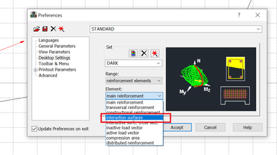

FYI I like to use the "Robot" theme which is a dark theme, however the N-M curve is not visible with that theme:
(as a new user seeing small details like this missed, which in my short time with the program have been abundant as far as UI inconsistencies or lack of function, leads to a sense of questioning if small details in calculations are being missed as well)
Based on this result it appears that the Whitney Stress block is used for the compression region, can you please confirm this?

" however the N-M curve is not visible with that theme"
Yes, its small UI problem. In fact, 3D and 2D diagram color should be depend on RSA preferences definition:
Unfortunately, it have impact only on 3D curve... I'll report it.
