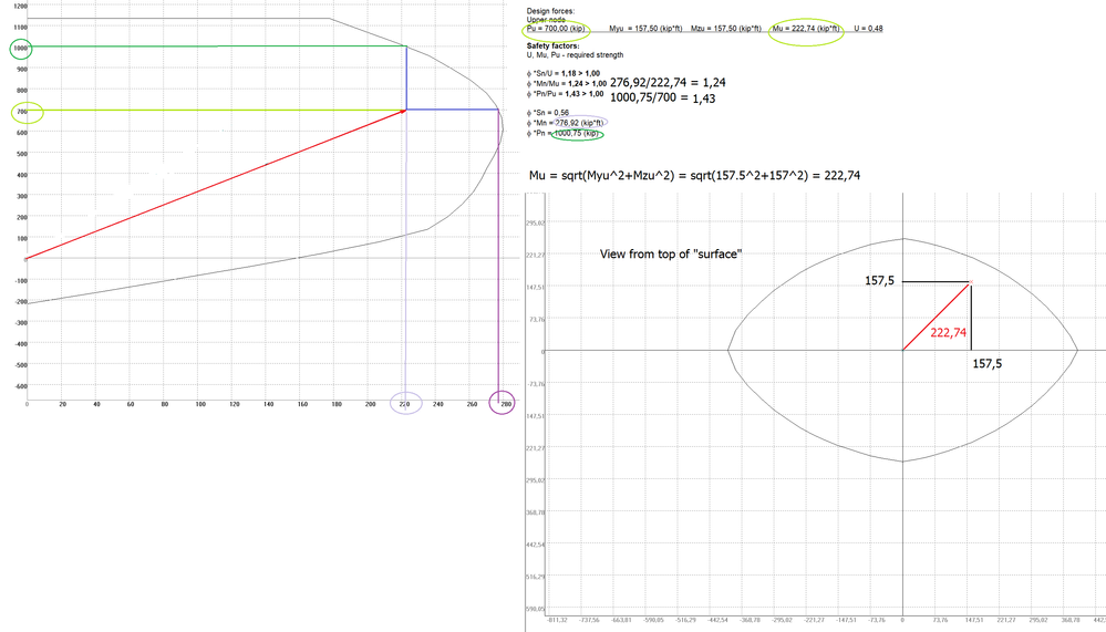

I'll try to explain what is in the calculation note under variables: Mu, phi-Mn, phi-Pn.
Drawing will be the best I think. To have nice drawing I've took your original example:
and I've multiply force by 2.5:2.5.png
I hope that drawing is clear in this moment
phi-Mn - maximum capacity for moment when acting axial load is fix
phi-Pu - maximum capacity for axial force when acting moment is fix.
Of course it is true for each case but in your original file phi-Pu is equal maximum phi-Pu (acting moment is relatively small) in the case where forces are multiplied by 2.95, distance between Pn and phi-Pu is too small to show it on the drawing.

ah thank you, I had a feeling that's where those results where coming from. Was able to reproduce Phi-Mn at the consistent axial M-M slice. Will double check phi-Pn know that I know the reference.
