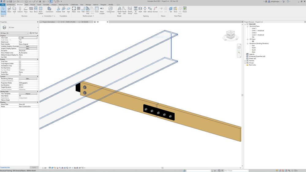

how can i make some connections like in the picture
wood steel connections?

Hi @Martin.EckartJLZX3
You will need to build this as a custom connection using the contour tools, plates, bolts etc then put it all together
I have actually done a webinar on working with Timber in Advance Steel and built that connection, you will find it on this page
https://graitec.co.uk/cad-courses/training-tutorials-and-webinars/advance-steel-content-portal

Martin.EckartJLZX3
but i cant use bolt connections with wood beams + plates , only with steel beams + plates
is there another option?

Rob_Merriman
I don't have my.computer on at the moment but I'm.usre you can bolt through a timber bean, how have you created your timber beams?
The other option is to model them using the Steel beam command changing the section size to a timber section then the material to timber

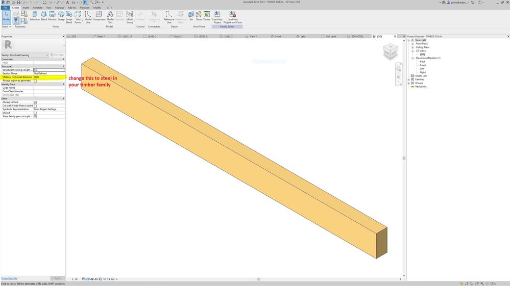

PhilipLTnz
I've created new timber families which have the "Material for model behaviour" set to "steel" as we do lots of timber/steel structures.
Use Shear plates for a lot of my timber/steel connections works a dream.

PhilipLTnz
 Within your timber structure element (frames & Columns) change the highlighted field to steel.
I'm newish to revit and guess i'll get told off but the only way I have found to get revit to work with timber/steel connections.

dali.jmal
Section Shape should also be : Undefined. Then it will work fine
