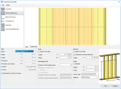

Hi W Estrada,
Welcome to the Forum!  I tested this in Revit 2017.2.3 with the extension and cannot reproduce the results you’re getting.
I recommend you retry this with the following steps:
  1. Make sure you’re in current update of Revit 2017 using your Autodsek Desktop App or downloading from you Autodesk account. See How to tie the Build number with the Revit update
  2. Ideally, as you do these steps, use Screencast to capture the video (so you can post here if further assistance is needed). Note that Screencast allows for audio narration as well if you turn a mic on.
  3. Start a new project using a default out-of-the-box (OOTB) template. I used the architecture template.
  4. Create a new generic 6” wall.
  5. Select wall and use the extension.
  6. Take note of the settings being used in the extension dialog and hit OK.
What are the results?
If it works, then you’re in business.  If not, post the Screencast video here (or some screenshots) of the results and your extension dialog settings used.

Hello Martin
First of all thank you for getting back with me.
I did the step by step and it work perfect, I made a new wall family 2x6 Stud wall this time and I sense like everything id working fine.
once again thank you for your help.
