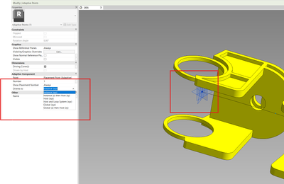

I am attempting to create a family for Amphenol's Cable Link system. While using the repeat function in an adaptive family, the models begin to flip by 180 degrees. I have tried every setting for the "Orients to" parameter belonging to the adaptive points in the nested families, however nothing changes. The model is a bit crude, but this is preliminary. Any suggestions?

Hi have you explored the options for the Node Alignments and possibly using Host driven options?

Thank you for asking, yes I have tried every option for the node alignment to no avail unfortunately.

Is the Orientation in the imported Family conflicting with the Adaptive Line Family?
I found this which may offer some guindance?
