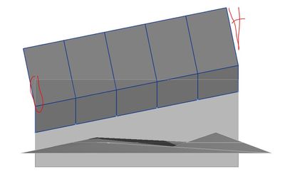

Attempting to create a workflow for modelling development recession planes along site boundaries. My steps for that workflow are:
  1. Created a mass using the boundary as the profile.
  2. Added a spline along the face which will follow the z values of the topography.
  3. Divided the line into max segments (1000mm).
  4. Added my component to the fist segent and applied the repeater.
It mostly works as I had hoped but I cannot figure out why some components in the repeat have flipped their orientation. Ticking the 'flip' box has no effect. Lines instead of splines generates the same problem. Had a play with the 'Orients To' parameter but 'Instance (xyz)' still seems the appropriate option. Tried the component on the front/back and left/right axis - same issue.
I am now stuck for ideas. Anyone else?

Profiles are always perpendicular to the path are they not? This 'profile' has to remain vertical as that's how the restriction is calculated. I thought the adaptive comp. woudl allow me to keep it vertical no matter what.

Yeah it's fine on the flat but the baseline follows the topography. It works on a straight line (maintains consistent orientation) albeit the upper section doesn't stay vertical like it does with the spline.

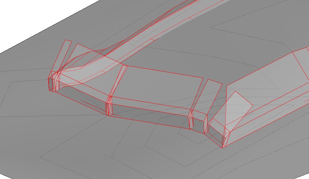

reubeno_peddlethorp
Rail profile is much much quicker to apply, but gives fairly poor results, especially on steep terrain.

Agreed. Not a good result.  Smiley Frustrated
