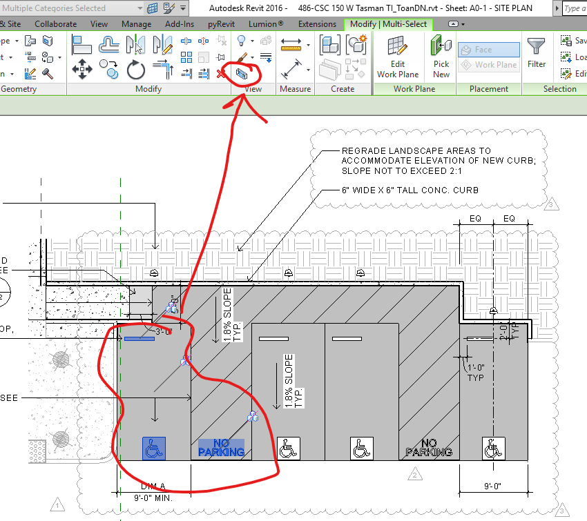

Hi
I remember doing this when I was at uni, but I can't remember how it was done; basically, we were able to make 3D views from a section cut without having to find it in the default 3D view. What I want is a 3D view of the below image (which I can do by finding it in the default 3D view and saving a custom 3D of it, but I know there's a quicker way)

First Create a Callout-->Open Default 3D view-->Right click on View cube-->select orient to view--> Select Floor Plans-->Find your CAllout plan name--> There you have it. The easiest way I can think of.
Select some of the elements in that view and use Selection Box tool, then stretch the section box as needed.
