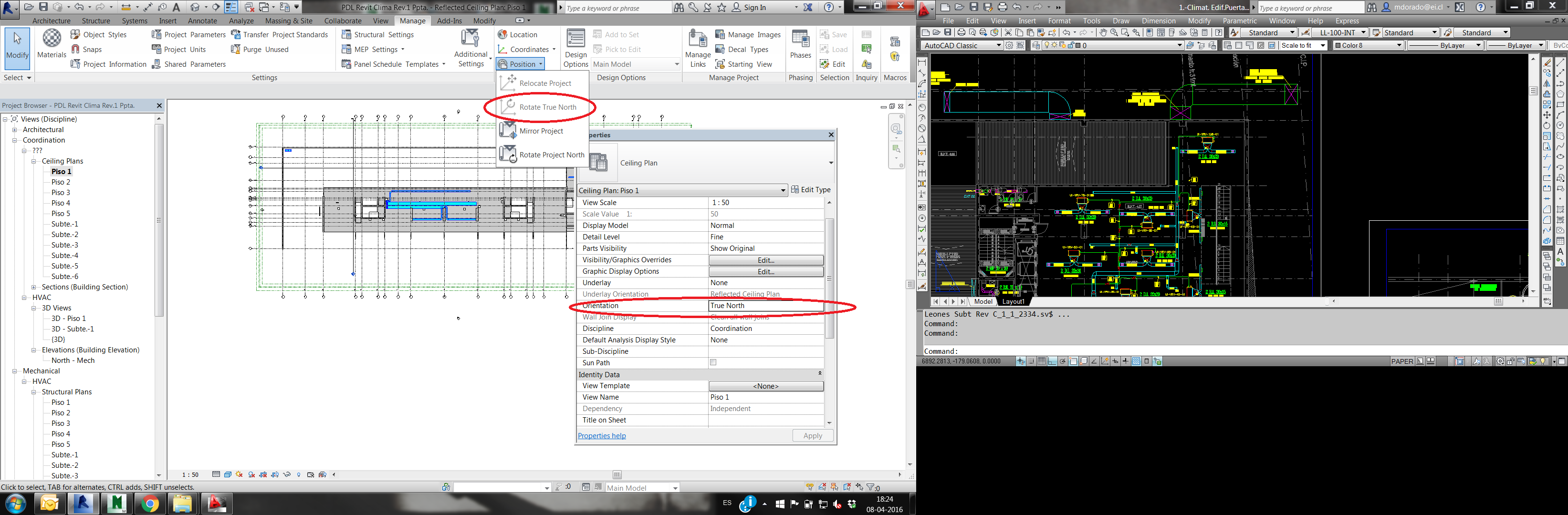

Hi Everyone,
I am working in a Mechanical model and I am not able to rotate the whole model to its true north because the tool is not activated. I don't know if it is because I am using a Mechanical Template, but which ever floor plan I open (either if it is mechanical, coordination or structure), none of them can be swithched to its true north. In some plans I am able to change its orientation to True North, but the actual tool that does the work isn't active.
Please,any help will be much appreciated.

Mahmoud.Ziedan
Dear,
You should go to view properties and then find down a property named Orientation, you have to select True North instead of Project North. Then everything will run perfectly.

mdorado
Thanx BIM-Mahmoud for your response, but I have already done what you say and the Rotate True North tool still isn't active. Please see the image I've attached.
Have you any ideas as to why this isn't working?

mdorado
No, the problem is not yet solved. In floor, structural or mechanical plan, the Orientation option in the properties dialog is not active, so I can't switch it to True North. Please check the attached image.

SteveKStafford
Any chance your view is assigned to a View Template? Check the Properties of the View > View Template. Is there a View Template name there instead of <None>. If so then a View Template is in charge, you have to either remove the bossy nature of the View Template from the view or change the setting in the View Template instead.

Dear,
As shown in the image you send, the view properties are locked. Kindly check the View templates in the View properties, it should be none.Check attached.

mdorado
I am just using Revit and not Revit LT.
However, I was able to solve the problem. It was, as you guys said, due to the fact that there was a template setting assigned to the floor plan views. So I turned that to "none" and it worked! I was able to rotate my model to its True North.
