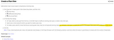

A site view is a floor plan:
Unless its maybe been created as a 3D view looking from above.
No mention in 2025 "What's new" of any change to behaviour:
https://help.autodesk.com/view/RVT/2025/ENU/?guid=GUID-C81929D7-02CB-4BF7-A637-9B98EC9EB38B
Help topic doesn't seem to have changed from previous versions?:
https://help.autodesk.com/view/RVT/2023/ENU/?guid=GUID-CD5FEE13-B63E-4668-AC03-7D0E8A4C9698
https://help.autodesk.com/view/RVT/2025/ENU/?guid=GUID-CD5FEE13-B63E-4668-AC03-7D0E8A4C9698
I also just tried it in a site plan view set to True North with a view template active and it worked fine, in 2025.
If you do it in a view set to Project North you get an error:
Its good that you got it to work for you but I don't think your perceived reason is correct, I think there must be something else going on with your model.
