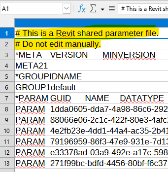

Hi iainsavage,
I have a question regarding shared parameters and type catalog. The reason I'm asking is similar to the situation with the .csv file I created. So far, I've only created an elbow for a 100mm Nominal Diameter, but as shown in the .csv file, there are 17 elbows of the same type with different values, including outer diameters, inside diamter, thickness, and so on.
I'm confused about how to proceed: do I need to create each one indivdually? Would using a family type catalog or shared parameters be helpful in this situation? I'm struggling because I don't even understand the different between the two, or how to use them correctly.
I'm asking these questions to make sure the process I'm following to create these families is correct and that everything is on the right track. I would be extremely grateful if you could explain this to me.
Thank you very much again!

"When creating families, what exactly does "shared parameters" mean?" Shared parameters are ones which you set up for use in multiple families and they are stored in an external text file so that you can import them into families or projects. They can be used in tags and in schedules. You can obtain ready made shared parameter files from some sources but I think you would be better developing your own company ones. Apart from the advantage of being able to use them in tags and schedules, the other advantage is consistency, for example if you wanted a parameter  for Standard and you're going to have this in every family then make it a shared parameter so that it will be the SAME parameter in all of your families and will appear as one column in your schedules. If you don't use a shared parameter for this then the Standard parameter in each family will be a DIFFERENT parameter in each family even although it has the same name.
https://help.autodesk.com/view/RVT/2024/ENU/?guid=GUID-E7D12B71-C50D-46D8-886B-8E0C2B285988
2. Do they always have to be in a .txt file, and how do I create that file?
Yes they need to be in a special text file. The file will be created when you create your first shared parameter. You DO NOT edit the file manually.
You can have more than one file if you want.
See the link above.
3. What's the difference between shared parameters and .csv file I edited?
The .csv file will be either a type catalogue or a lookup table depending on how you are setting up your family.
These tables only apply values to parameters which you have already created, they do not create new parameters.
If you create a new shared parameter, e.g. Standard, then export family types again there should be a column for that in your table.
