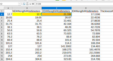

Firstly, you may have started with the metric Generic Model template but you'll need to change the family category to Pipe Fitting and set the part type if you want it to connect to pipe in a model.
You then need pipe connectors in the fitting and you associate those connectors to a parameter representing the pipe size, for example only:
- when you use the fitting in a model and insert it into a pipe the pipe connectors in the family will read the pipe size value from the pipe and then automatically pass this value to the pipe size value in your fitting. You then don't need to create types in the family - the fitting size will be set automatically when inserted in the pipe.
Use your table as a Lookup Table. You then use a formula which pulls values from the table.
https://help.autodesk.com/view/RVT/2022/ENU/?guid=GUID-91270AEF-225A-49D7-BF84-1F44D1E3E216
So you would use the pipe size parameter as your lookup value for the lookup table. Then use the appropriate column header in the formula to extract the associated value for the particular parameter that you are trying to set.
Note that the first column (A)  in your table is ignored.
So for example:
Associate your pipe connectors to the Nominal Diameter parameter.
It is conventional to use a parameter called LookupTableName to assign the table name to a parameter but I notice that you have ignored that convention and called your parameter lookup table name
For your Outer Diameter size use the formula  = size_lookup (lookup table name, "OD", Nominal Diameter[some formula here of your choice], Nominal Diameter)
This formula, in plain English says:
Look in the lookup table specified and find a value which matches the current value of the Nominal Diameter, then when that value is found go across that row to the column headed OD and pick out the value in that cell, assign that value to the Outer Diameter parameter, but if the Nominal Diameter value is not found in any row then use the formula Nominal Diameter[some formula here of your choice] to set the value of Outer Diameter instead.
So in your case, the pipe connectors get the Nominal Diameter from the connected pipe size.
This value is found in row 2, yellow cell.
In same row 2 and column OD, orange cell then assigns the value to the Outer Diameter using the above formula.
Be aware though that your pipe size in the model must exactly match the value in the table otherwise the "not found" value will be assigned.
Message 5 of 25
