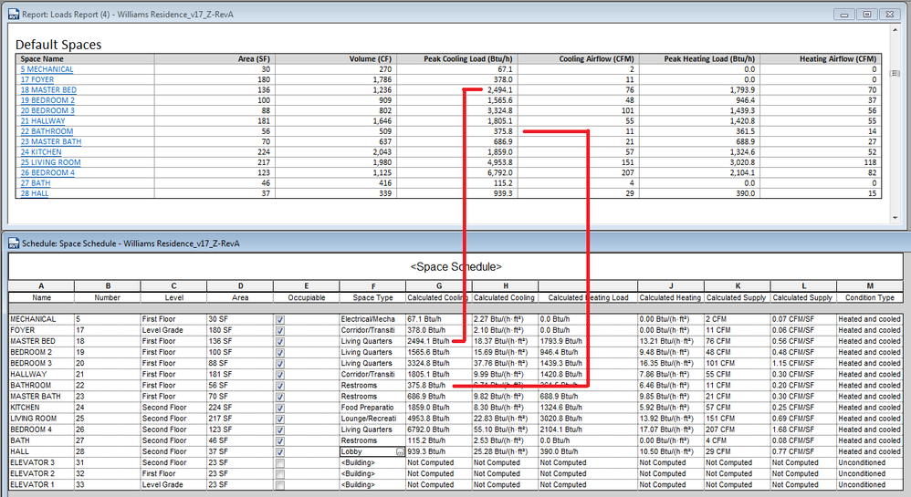

How to have Revit calculate Heating and Cooling loads per individual room volume instead of whole house volume? In the real world not every room is balanced due to the sun hitting the house and the shade, and you notice that in a house there are some rooms that are hotter or colder than other because the HVAC system is not balanced. The system is based on whole house volume not individual room volume. Need to have Revit calculate individual room volume to give accurate information.

Yes I provides heating and cooling spaces for each individual rooms and when I run an analysis report, Revit provides incorrect information for smaller rooms compared to larger rooms with the same ceiling heights and wall R value the only thing that is different is the volume. The Analysis breaks down room by room but it seems Revit is still basing the calculations on the FULL whole building volume then separating it by room instead of individual space then combining the whole building.

I have attached jpegs of two rooms that have inaccuracies in the BTUH calculations. The Master Bedroom and bath room are on the same floor. With different sizes but the BTUH are way too high. with occupant load of zero "0".

Thank you for the Model, it made it a lot easier to assess everything. My findings are shown below:
The revised Loads Report along with Space Schedule and new Btu/h values can be depicted from the images. (I'll explain how I got to it further down).
Below is a comparison between two load reports, one using Building Elements and Function Parameters (Space Type) and the other one using Building Envelope Exterior Elements. I generally use the Function Parameters, but you'll notice that there isn't a major difference in all spaces between the two reports in this scenario.
Occupancy Schedules along with Space Type (Lighting and Power Schedules) are also important. Let's have a look at the Master Bath below. Space Type >> "Restrooms" >> Occupancy, Lighting and Power Schedules >> "Residential Lighting - All Day"  (This can be changed to your liking with some of the other predefined Schedules). I used the same occupancy, Lighting and Power Schedules for each of the Space Types in you Project.
Lastly, one of the main culprits was you Space Limit Offset. The Master Bath provided you with desire Btu/h readings, but as you mentioned, the Master Bed just below the highlighted space and Bathroom to the left of the highlighted space gave Btu/h readings which were very high. I simply assigned the same Limit Offset to all of the Spaces on the First Floor. Then I took the Limit Offset assigned to the Living Room on the Second Floor and assigned the same Offset to the rest of the Spaces on the Second Floor.
