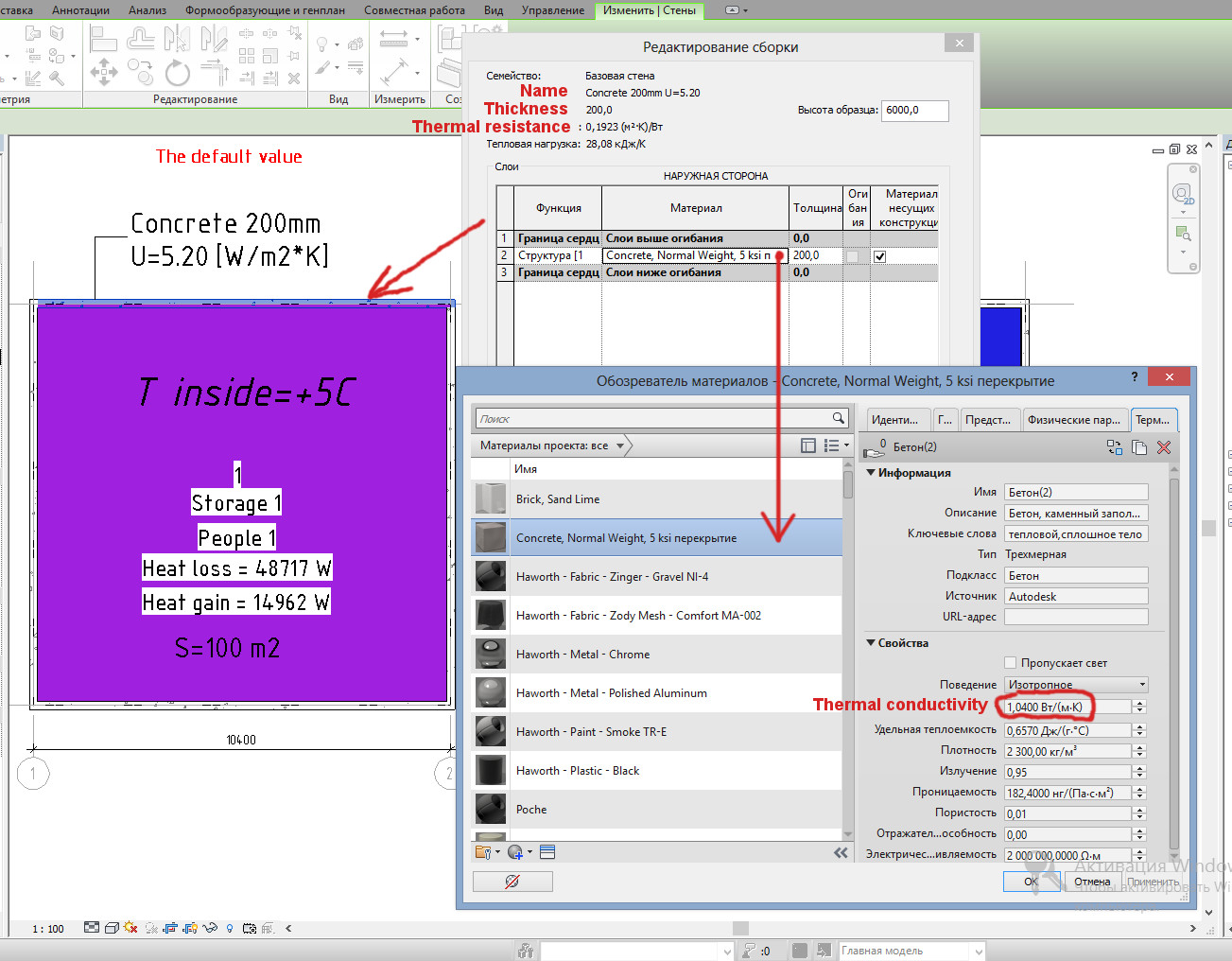

Thus calculated heat transfer coefficient (call him as in Revit, the letter "U"), ie U = 1/Ro.
So, it seems that Revit simply ignores the value Rin + Rout and calculate heat loss (heat gain calculation has not yet been tested) only based on the value of the thermal resistance of the wall, ie R.
For example, a wall consisting of concrete, 200 mm thick, the thermal conductivity K = 1.04 [ W/m2 * K] (the value of 1.04 is taken as an example , although it is stated in the thermal properties of the material for concrete default).
Create a wall in Revit with these characteristics and we've got this:
Thermal resistance R = 0.1923 [ m2 * K / W].
Heat transfer coefficient (U) = 5.200 [ W/m2 * K]  and calculated as 1/R.
Here is a screen of what happened:

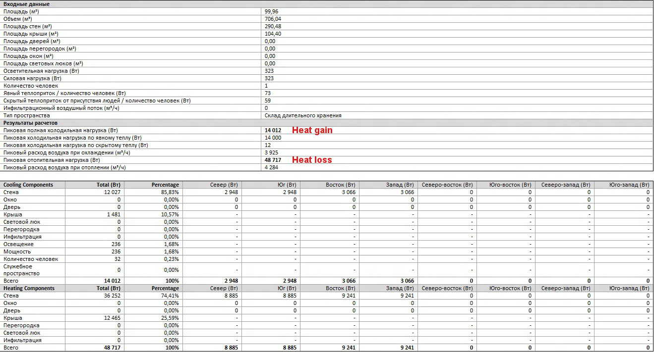

Now, to verify the calculations let's create a space 10 by 10 meters with floor and roof. And let's take concrete wall 200 mm, which had just been created. The internal temperature of 5C degrees. Outdoor temperature -19C.
Doing Revit analysis of heat gain and heat load and the output is this:
Naturally assume that everything is OK. But the first check in any other program such as Rehau RAUWIN or calculation in just Excel will show that Revit ignores the value Rin and Rout.

If we'll set in Rehau RAUWIN program a similar space, which is already calculated in Revit, we obtain the following values:
Rehau RAUWIN calculation
From this it is clear that a significant difference in the calculations.

So, here's a way that you can use to create a wall with the correct value of the heat transfer coefficient.
For a visual comparison, I created two storage #1 and #2 with the same dimensions and parameters.
Storage # 1 have the concrete wall, which creates Revit default, i.e. excluding Rin and Rout.
Storage # 2 have the concrete wall too, but I adjusted right R factor by adding coefficients Rin and Rout in my own way.
I created them by setting the appropriate values of thermal conductivity in the material properties. Thus Revit will think that it takes into account factors Rin and Rout in the calculation of heat loss.
Take a look:
Storages data
Storage # 1 concrete wall (by default):
Concrete 200 with U=5.2
Storage # 2 concrete wall (corrected). Let's make Rin
Resistance heat absorption
Now Let's make Rout
Heat transfer resistance
And after all the manipulations we get it here:

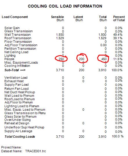

Nothing seems to make mathematical sense with their calculations. If I specify 1 person in a space with 250 Btu/h sensible and 200 Btu/h latent, the load report will tell me I have 393 Btu/h of gain from people and 190 of that is latent. Why???
This forum really needs the emoticon where the smiley face is banging his head on his desk, because that's how Revit usually makes me feel.

It does this with even the most basic model made from the default mechanical template (attached). Do you guys get different results?!? What am I doing wrong?
