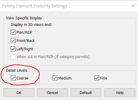

kadmonkee
confirm that when you are in the family editor, select the elements in your elevation, or 3d view they are turned on in your Plan / RCP  and set for each Detail Level in the Family  Element Visibility Settings

kadmonkee
while in the family Editor go to a 3d view select everything right click and select Visibility.
depending how the family was created, check all the boxes until you get the display you want.
see previous posted image
