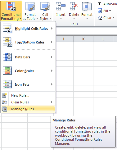

The attached files are for reference. I setup the Excel file in so that it will format the around 45 rows for the columns present, but you'll be able to play around with it and setup your own sheet as required or use the attached one as a starting point. Excel Conditional Formatting can be seen and managed here:

If I understood what you're trying to achieve, then there will be one step which you'll have to do which isn't automated... That is to copy and paste the info from Notepad to Excel and save the sheet for others to use, then you won't need to train the rest.
