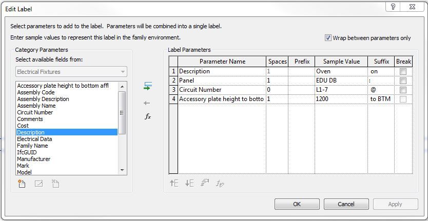

If I have the same type of accessory, say a fused fused connection unit, used at 450mm affl to the bottom as well as 1600 affl to the top, in different locations for different uses.
The low level element may be for a radio frequency speech broadcast unit at a reception desk and the higher element might be for an intruder alarm main panel supply.
The images below might help, all of the text is Tags generated from parameters, none of it is typed by hand as plain text. I need the parameters available to achieve this quickly and accurately.
Each family has parameters and values for both top and bottom elevations at the same time. The way that I show the elevation i want is to choose a tag which references either the top or bottom parameter to show the information I want to display.
By origin I mean where the geometry starts in relation to the floor, all my families are inserted at an elevation of zero, it is the geometry in the family that moves, not the family instance itself.
Setting out to BTMSetting out to BTMSetting out to TOPSetting out to TOP
 Parameters in familyParameters in family

I am having a hard time following @Scott_D_'s recent posts, but I think I agree with @casquatch regarding defining the origin. I, Iike @Scott_D_, have created all of my families so that they are always inserted at an Elevation of 0, and a separate, taggable parameter for their actual height above level. This sometimes causes problems, however, and I would much prefer to just be able to tag the elevation.
Since there is a 'defines origin' option for reference planes, our families can be created depending upon whether we want the top, bottom, or centerline to be the elevation. We just have to check that reference plane as the origin.
