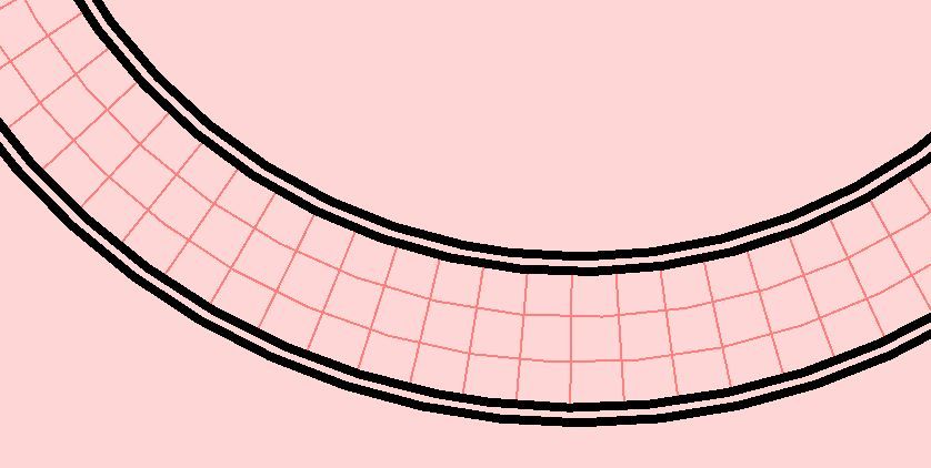

i suggest to enhance the Surface pattern (model pattern) alignment in revit,
to give the ability of doing the align option or move on the surface pattern (model pattern) on the wall "in elevation" when the wall is a curve or an ellipse in the plan.
4 Comments
in curved building we need to create curved floor pattern or curved ceiling which have to spent a lot of time to draw it manually
so, we need hatch to be enhanced to match the need of curved building
many thanks
Curved ceilingCurved ceiling

Provide the ability to align surface patterns to curves. Ie floor tiles around an elliptical opening. It may need to be a new type of pattern to allow it to function properly, almost like an array along a path.
This would be especially useful for detailed interior tiling plans.
