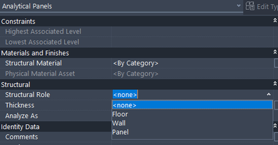

When defining structural analytical elements in Revit, the Robot Structural Analysis "cladding" panel type is not available to be used in Revit.
This is vital for the most basic workflows from Revit to Robot.
As sending the model from Revit overwrites the Robot parameters, so drawing a normal "panel" will so that area loads can be applied in Revit removes changes made in Robot.
