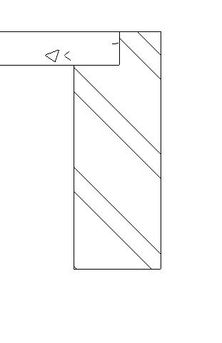

Improve wall take offs especially when a volume of floor as been cut out from the wall
Below typical sections of a wall with cut-out volume of floor
Wall 1 - 105 wall on 220 wall
Wall 2 - 220 wall (floor cut out)
Wall 3 - 220 wall with 5 Plaster (floor cut out)
Below is a wall take off of the above sections
Wall 1: scheduled correctly
Wall 2 & 3 : Floor volume cut out. It should the indicate a portion of the wall (cut) with heights to to be tabulated in the top and bottom offsets and also indicate the correct width for these portions. (see wall 1)
Regarding widths
Currently the width indicates the total wall width. There should be a default in built parameter Material: Width, which relates to the width in the layer build-up window (currently unavailable, see screen shot Revit 2022 below)
In addition there should be a parameter indicating if a layer is in the core or not in core. Going a bit further if not in core that it is either exterior or interior side.
