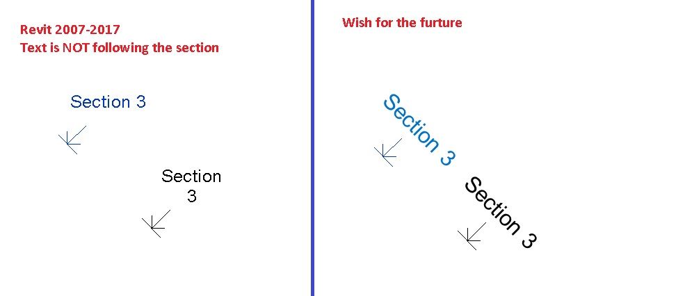

Please make text in sections work properly.
Since Revit 2007, the text has not been able to follow the section.
See attached pic.
Section
lionel.kai
When you're talking about text not following the section, do you mean text (and inner geometry) in the Section Heads not rotating with the outer geometry to align with the section cuts (see attached)? Because regular text in sections can just be rotated.Structural Analysis-Default KAI_x48 Sect.png
ViviNyehuusAndersen
Yes i mean text in Section head/tails. They stay readable, even do you remove this. It wont rotate with component even do you tell it to. The section you shov looks fine, but in Denmark sections can´t look like that. thay must look like the picture ive attached.
