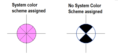

When users have a Floor plan view with equipment on a level above. The symbol that Revit can automatically place for Duct & Pipe Rise/Drop is very useful for documentation. This shows immediately & automatically that the duct/pipe is traveling beyond the scope of the Floor Plan.
However when there is a Plan Region over a Floor Plan, Revit negates the ability to add Rise/Drop symbology. on many plans, particularly areas with different Level Above/Roof heights a Plan Region is needed but so are the Rise/Drop symbols.
Autodesk, can we have our Rise/Drop symbols in all views?
The other part of this Idea/Request;
 It appears that in Revit builds as late as 2018, that if you print in color you lose the function of Rise/Drop symbols printing over your system color.
This would be helpful for documentation to keep users from having to place notes, and allowing Revit to be beneficial for adding in the annotations as it is assigned. system color scheme duct rise & drop.pngThis keeps us from maintaining annotative & graphical consistency between Color and B&W printing. The annotations should behave similarly between the two options.
Autodesk, We need this for printing in color!
