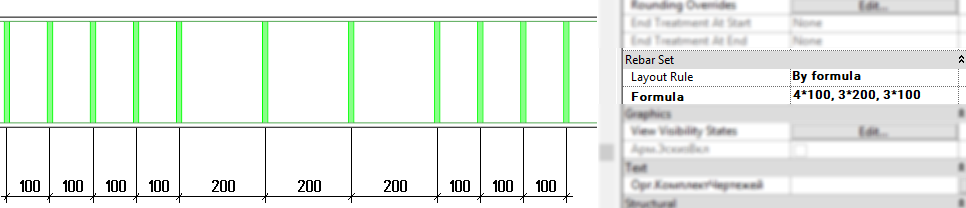

2. "By formula"
When reinforcing columns and beams, it usually requires the installation of transverse rods with a variable step - a step smaller at the end, more - in the middle:
Now I have to use 3 different sets of rods. This is inconvenient, especially when editing - three times as much work.
The method "By formula " should work like this:
"Rebar presentation" and "Multi-rebar annotation" should work in the same way as in method 1.
For "Rebar by area" and "Rebar by path" this method is not required.

FIRST DAY I started using Revit as a structural designer and drafter in 2018, I literally wondered why this super critical feature is not available in Revit 2018. Closer spacing of stirrups in critical zones of beams and columns, is mandatory by many concrete codes all over the world. Doing this task with current tools in Revit, is frustrating.
I know this feature is added to Revit Road Map. So I'm hopeful to have it in the next version.
I strongly suggest to make this feature smart. By saying smart, I mean Revit should use Artificial Intelligence to check each column based on code (like ACI 318-19) and suggest a number for spacing and L0 length (L0 is defined in below picture).
