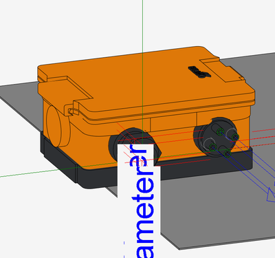

Please make it possible to add Yes/No parameters to MEP connectors.
Take a radiator as an example, normally this has 6 connections, but we only use the tow of them.
But as it is now, we need to have a family for each connection type but this its still the same radiator, witch is confusing fore the contractor and the quantities.
Please se attached picture.

I have an electrical manhole family, which has several conduit connectors. Number of conduit connections will vary according to the condition. Literally i'm  making around 20 types of same manhole family for a small project in order to match the no.of connectors in each condition.
BUMP
Its more convenient sometimes to create types or instances.
I don't want to create 2 same families with different number of connectors...
As an example:
22ADP-154 | Duct Sensors (Air) | Sensors / Meters | Belimo Switzerland Official Site
22ADP-154D | Duct Sensors (Air) | Sensors / Meters | Belimo Switzerland Official Site
these are almost identical, the difference is that the first has 1 power and one "duct" connector,
and the second has 2 power connectors and 4 "duct" connectors.
