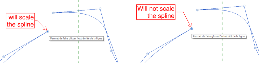

This comment should have way more than an average of one vote per day (15 votes in 15 days). I might actually use the spline tool if it were easily edited (even if I could just Split the line, that would be a HUGE improvement to the tool). The way it currently works is just not at all useful. The number one thing about drafting is that "things change". Well, splines are not easily changed/modified. So, they don't get used. I need to be able to control both ends of a spline AFTER I draw it. It currently acts like an invisible straight line and scales the whole dang spline if I move one end after the spline is drawn. That is pure insanity. Under what condition is that a desirable function??
Evalucia
I would like to add that most of the time (in my case), a spline need to be closed : wich is impossible in Revit.
We need to draw a small line between the start and the end point.
It would be nice to be able to close a spline (either by selecting the starting point or by pressing "enter" when done)
Plus, the fonction to "add point" puts it in the midle of the "segment" instead of where the click is done. Which result in an additionnal step of selecting this new point and move it where we wanted it (where we just clicked).
To cuddyUCMTKI : got the same problem of needing to move the end (or start) point and the spline was scaled.
Then I found out if you press tab 1 time, the "outside circle" will be selected (insted of the inside dot) and then you can move the point without scaling the spline. See image :

Thanks @Evalucia , that is an excellent tip. Even though I use the Tab key for a lot of things in Revit, I never would have thought to use it on the end of a spline. Thank you!
That would be a good tool tip to add to the drop-down in Revit (when you hover over the spline tool).
