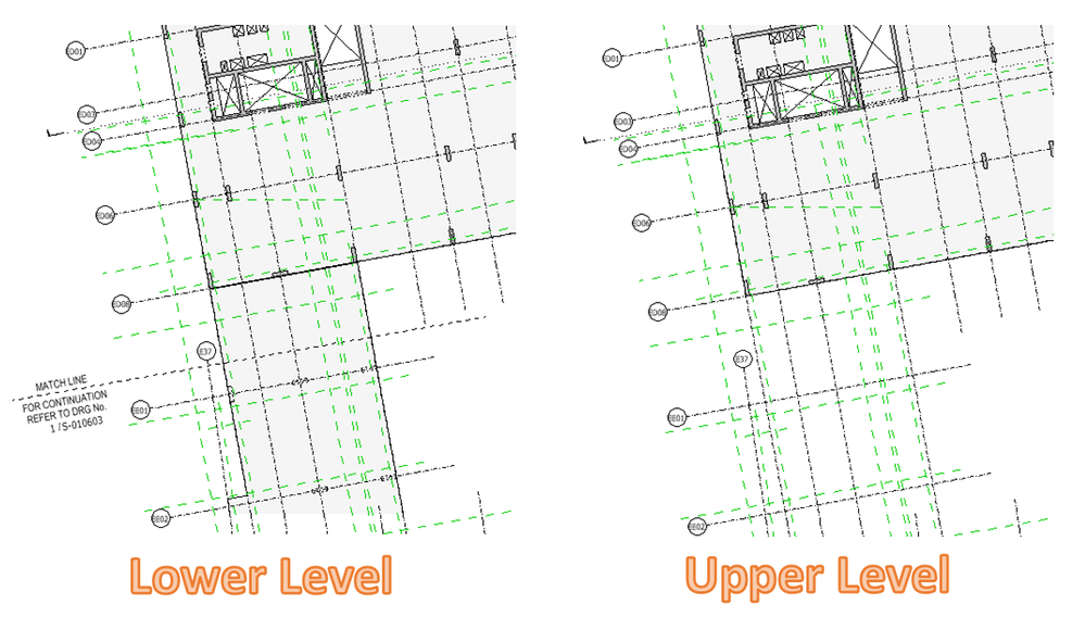

It would be great to have additional control for grid lines similar to the mathline.Grid Line Idea.PNG
Looking at the Upper Level, it is not ideal to just select the grids and hide them manually.
Having the ability to set the Grid Line top constraints, like the one we have in matchline will avoid hiding the grid lines manually in the plan.

This sounds as simple as adjusting the 3d extents of the gridlines to below the level you do not want them visible in. Am I missing something here?? Is it just having the property available to the user in the properties dialog box and to be able to adjust from plan?
allan.cantos
@Anonymous I am not after what you'll see in elevation. I am after with what you can see in the plan. If there is only a way to control the top constraint of the grid line, similar to the matchline, it will avoid hiding the grid line manually for every single view.
@Anonymous if there is only the parameter to control this in the properties dialog box,  I wouldn't be submitting this idea. If you find the simplest way to do it, please share.
If the 3d extents does not extend past the top of the level it will not show in the floor plan. You can adjust the 3d extents in a section (uncrop it). Grab the 3d bubble and drag it down below the level you don't want it to appear on.

@allan.cantos You know you can adjust the 3D extents of Grids, right?
What's confusing is that you keep mentioning having to "hide grids manually"...
I thought you just wanted a way to control the 3D extents with parameters, instead of having to use an elevation to control the 3D extents graphically:

@lionel.kai ...oh, I know what you mean but by doing this, you need to create a section that is perpendicular to the grid lines and adjust manually the 3D extents which, I don't think not a good workflow as this creates additional work.

@lionel.kai agree you can just select all the grid lines and set the top constraint in the property and you're done.
@Anonymous "The 3d extents of the gridlines have to be modified one time during setup" - how would you do it, manually set the 3d extents of the grid lines to a certain level so it won't appear to the next level (see grid line E47 in my previous post)? Doing some work manually is the idea that I'm trying to avoid here which can be achieved quickly by adding just a single parameter to the grid line properties.

@lionel.kai how do you adjust the extent of a grid when you have radial grids as in the first post? The only way you can do this, correct me if I'm wrong, is to create a section to each individual grid lines and adjust the 3D extent down to a certain level.
This is just an idea to automate things rather than spending some time adding the sections and adjust the 3D extents graphical representation manually. When I say manually, you'll create a section then you need to select the grid at section or elevation view, then modify the grid by draging its view specific extent.
How easy it is, do you think, if by looking at plan, you know which grids stops at a certain level (with an offset above that level obviously), to just select all the grids and assign a top constraints and an offset from that level?
I would agree with the offset, by the way, from level. We don't normally stop our grid lines exactly at the level. This offset can be part of the grid line parameter similar to the "Matchline" parameters from my original post.
