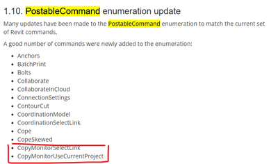

I think this idea has come to reality, In Revit 2022 they've included several new Postable commands and Copy Monitor/Select Link is one of them!
Find out more on https://www.revitapidocs.com/2022/f6ccdc1b-6ac3-9c49-d0bb-8a7d1877eab0.htm
tamas.deri
@465565873sthanks, but no thanks. This is next to nothing. I'm sorry to say this but it's still useless,.

Any updates in this feature ? Adding postable command and call it a day doesn't reall help anyone....
