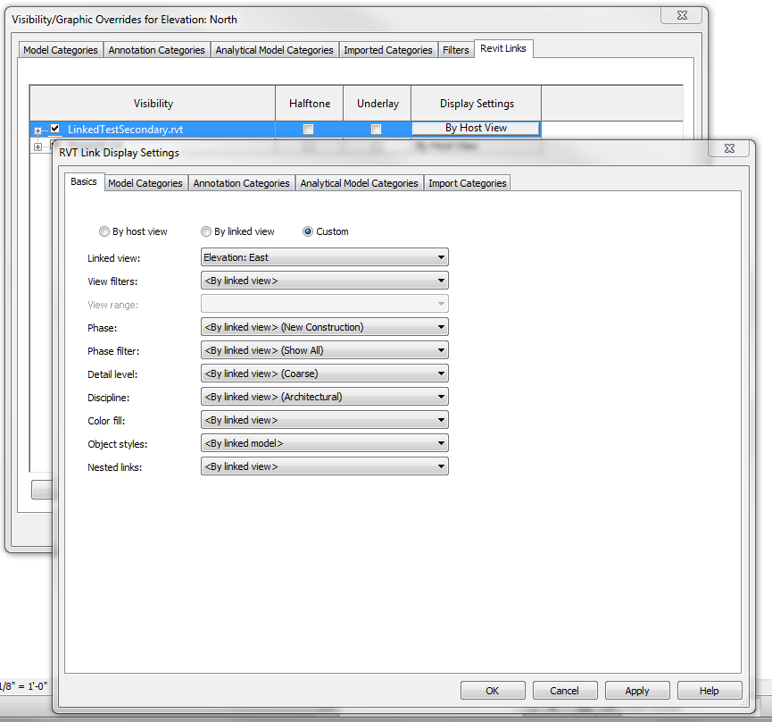

I would like to have access to at least read the Revit Link Display Settings through the API. I want to be able to see if a filter in the Link file is being applied and if the current view is using the link display settings or the main file's settings.

I don't understand why this idea was proposed in 2016 and nothing has changed until 2023. AE firms keep updating and changing design files. I have to change linked background files for every single view VG override Link Model session individually.
@ycai9HR9Q - View templates will capture settings of linked file overrides... and not too many folks work in the API/Dynamo.
aaron_rumple
View templates can only capture setting for linked files AFTER they have been linked. Which is the reason these settings need to be accessed programmatically. MEP consultants can have a lot of subcategories that aren't defined until loaded. Additionally, if a file is unlinked and relinked - you start over on the settings. Being able to get at these settings programmatically, will let us push the desired settings to all of the view templates at once, rather than edit them one-by-one. It's such an issue, we're doing a lunch class next week to discuss the issue.

@aaron_rumple,
There are other option depending the overrides with viewfilters:
A. Use worksets, if the links contain only a limited number of Worksets (and unique between linked models) add a workset to your model with that name. Now create a viewfilter for the categories + that workset and add it to view/templates to override the linked model
B. Use viewtemplates and use another common paramter to filter items to override. For MEP models I often use the system names (duct etc) to override, as they often can't be overridden by VG.
These can be programmed by API / Dynamo, inspect/check the linked models and create appropiate viewfilters and set their override settings.

Hi, I'm currently using Revit 2024,
and have noticed there's a function to set LinkVisibilityType to ByHost, ByLink or Custom just like the options inside Revit App,
somehow my codes didn't work at all,
is it still not possible to set VG for links model or did I do it wrong?
