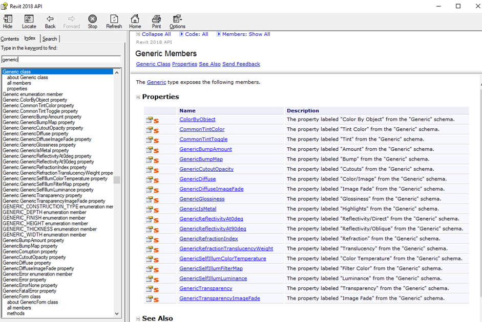

You can search for the schema in RevitAPI help. Here is the list of properties for an appearance asset of Generic schema: the property that is looking for is “GenericDiffuse”: the description in the help usually maps the name in Material browser.
Now, as “GenericDiffuse” is a property that can be connected to another property, like all a texture map, he has to do the following (this is based from the code snippet we provide for new method GetSingleConnectedAsset):
