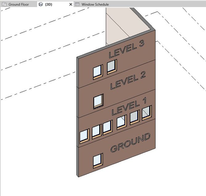

hey,
i've created windows schedule and what i need to get is a table like the one i made in excel as an example(attached below)
how can i achieve that situation that the schedule will count windows by the level of the building and then sum them all up?
thanks

well, i know how to acheive what you did, but i want my specific situation (because i have many types of windows and i want to make floor levels columns and not rows)
is it possible?

No, schedules are a bit limited in Revit, but you can export your schedule as csv and translate row/column in Excel.

Revit doesn't allow Filtering using Columns...
But if you are forced to use that Format, then It would be complete Manual..
1. Add the Parameters ( Text - Ground, Level 1, Level 2, Level 3 )
2. and Fill in the Numbers Manually.
Example..
Custom Window Scheduel - Manual ( the count won't come automatic for Levels, but default Count column works )Custom Window Scheduel - Manual ( the count won't come automatic for Levels, but default Count column works )
