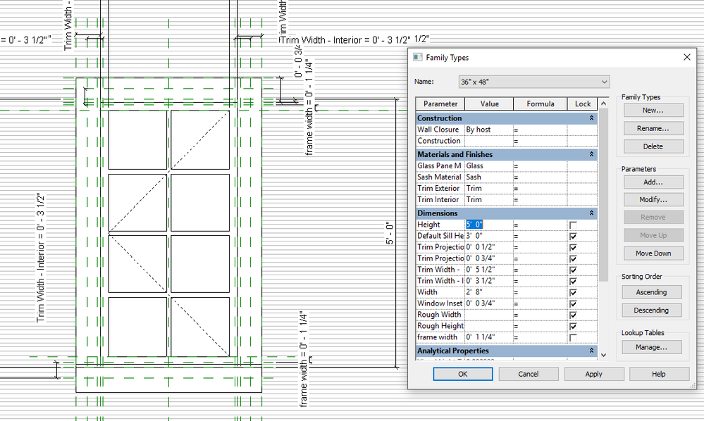

I created a window using the Window family editor, then used Create Extrusion > Create , then placed Reference Planes, dimensioned the frame widths, then dimensioned the mullions equally, and locked the dimensions, then picked lines, offset them from the reference planes and trimmed the lines to create the mullions. This all worked, and when I loaded the window into the project, it loads ion fine at the dimensions/window size defined in the Family Editor, but if I change the window height in the project using Edit Type, the top frame widens and does not keep its width as defined in teh Window Family editor. I'm not sure what I missed, but I could use some advice. The window family file is attached. Thanks.

You need the fix the constraint of the muntins and one of the trim.  Right now if the Height changes, the muntins break very badly.  If the wall thickness changes, the trim doesn't move and it can be sit inside or floating out of the wall.
If I remember correctly, you create this window based on one of the OOTB family and that one is kind of a mess per se.  If I were you I would at least create a separate generic model family for the muntins and nest it in this window family.

See the attached file.  I don't have time to make a screencast at the moment but you can dissect the family for now.  I only have like 10 minutes so I only looked at making the nested family work.  The rest are untouched.

I got into tyhe window family and opened up Family Types, and added Muntin Width and Muntin Height parameters under dimensions and made them EXACTLY the same as what you showed in your screenshot attachment - but the muntins still do not stretch with the window. See attachment for screenshot of Family Types that I created in the window family.

I will make a video. In the meantime, you should read on nesting parameters.
Before you think it doesn't work, why don't you open my family and add a few types with different Width and Height see if they work?

You only need to create the parameters that you need to control in the parent family.
Below is a screencast of a simple window with a nested muntin family.  I created everything from a blank template for clarity.

I did load your family into my project and the stretching of the mullions with changing host window sizes did work - thank you.
The only problem is, I don't know WHY yours worked, and what you did to make yours work where the host/nested window family that I created did not.
I went into your nested mullion family and did not see any parameters listed under Family Types. So then, what is it that you did to make the mullions stretch dynamically? Because when I read the Autodesk.com "Associated Family Parameters" (see pasted URL) text tutorial earlier, it made it sound like the nested family needed to have the same type parameters as the host family. I'm very confused.
