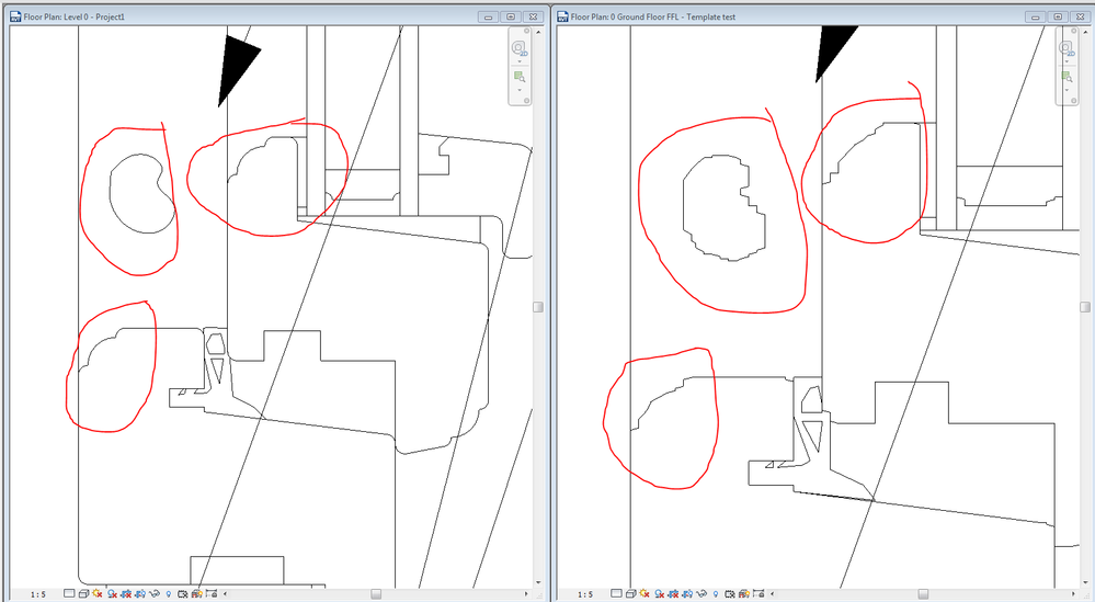

 In other case, using the same template in Revit 2017
We have created a detail using regions, lines and other annotation, and copy it in our company template (right) and in a default revit template (left), look at the differences marked in red circles, how the lines and regions are distorted.
 My graphic card is a Radeon RX 470, and my pc is less than a year old, so it shouldn't be a problem and more when in one template works ok and not in the other.
I never had that problem before, so any suggestion about the possible reason?

...almost looks like you have sketchy lines enabled.
Message 4 of 19
I have the sketchy lines disable, it got solved disabling the plants category, other of my colleagues said thy resolved it disabling the topography caterogy

Message 7 of 19
How far is your model from the origin?
Message 8 of 19
It is nearly finish, but the worst is that I can't find the problem and every new project is started in this template, so all will have the same issues

Hello @ennujozlagam,
I have found the all the graphic issues with the shadows disappear as soon as the planting category is off (As you can see compering the 3D view with and without plants). So checking it, I found that deleting the family "RPC Tree - Deciduous", those shadows problems are solved.
But I am sure that is not the real cause of the problem, because I placed these "RPC Tree - Deciduous" corrupted family in other project, and I don't have any shadows issues.
Also, I have other file, without these "RPC Tree - Deciduous" corrupted family, and completely purge, and I have other graphic issues doing hatchs for a details (In the image below, in the left is how it should be, and how it was drawn, and in the right image is how it is shown)
All of those files with issues have been started with our company template, so something might be wrong on it, but I can see what it is the cause.
And yes, I tried to change all the details view to Fine, and i see that rendering the shadows are ok, but the other problem with the hatch remain, so the cause is still there

Message 18 of 19
After a lot of researching and testing I found out that the issues where related with the model and the origin point.
Although my survey and project base point where close to the model, I didn't realize that the model was miles away from the internal origin point of the revit file.
See the solution here
https://forums.autodesk.com/t5/revit-architecture-forum/move-project-to-origin-point/td-p/7578661
Message 19 of 19
That's exactly what @ToanDN was alluding to when he asked you: "How far is your model from the origin?"
