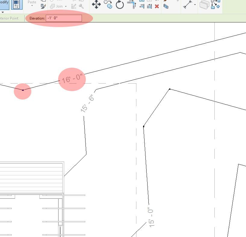

chughes
The below example exhibits the difference.  The preference is the defined elevation of the point on the toposurface is the same elevation as the contour line elevation.
You're highlighting a toposurface point (-1'-0"). How is this germane? If you close out of editing mode and place a spot elevation on it, it can read that "spot" (where the point is located) relative to Project Base Point OR Survey Point.

chughes
It is germane when you are defining locations for the 16' elevation contour to follow.
The contour line elevation relative to the top of slab is less significant than the contour line relative to surveyed back of street curb or site wall.  The toposurface point elevation is what controls the direction and flow of the contour lines.  The location of my slab (and Project Base Point) is controlled by site conditions, not the other way around.
I am simply looking for a way to have the toposurface points reference actual true elevations, not Project Base Point.  It would seem that I could draw the toposurface to true elevations, based on the Survey Point, without having to draw it first and then move it on the Z axis.

chughes
Native elevation, in this instance, is 16'-0" NAVD.
To make future manipulations to the site, after I draw it and move it, I create new toposurface points at -1'-0", not 16'-0".
