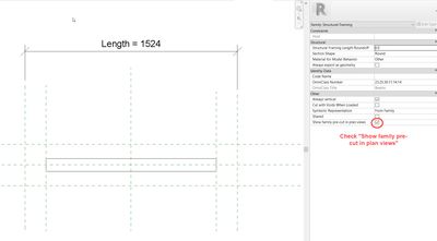

Hi all,
drawing up a model with some custom structural framing and for some reason some of the structural members show and some don't. I cycle through medium and fine detail with no changes, and coarse reverts it to stick. Any thoughts?

Thanks for the reply. Should have mentioned that phase are all set to new construction and I've tried cyclying through disciplines. They're all at around the same height, so its weird that some sides of the framing are being cut and the other is just invisible. Seems to be doing the same thing in section too. What am I missing?

What do you mean by "almost"?
Message 15 of 17
Well the initial issue was that some famiing member were being cut and others weren't. In the example you have sent me none of the members are being cut.
Message 16 of 17
Well then, uncheck "Show family precut in plan views".  The underlying issue is resolved by changing the Cross-Section Rotation.  It's a known and documented issue.  The other issue is that your family is sloppily built.  Whether or not that contributed to your specific issue; I don't know.  Maybe it did. Maybe it didn't.  Regardless, your "circular_column_90" family was improperly built.  I had to fix it because it was bothering me.  I'm surprised it didn't bother you.  Maybe you don't care, but I do -- ALMOST always.   😉

Ok look I'm getting the sense you've taken this somewhat personally. I only wrote "almost" because you didn't actually answer my question, and as you have shown (witihn our multi-message exchange) the real solution was "The underlying issue is resolved by changing the Cross-Section Rotation.  It's a known and documented issue".
The family I built was just modified version of another family, and now that I've rotated the cross-section as you recommended the problem has been resolved and will be fine for all my needs. I appreciate your eventual help, but also no need to be vindictive about someone declaring they haven't actually received an answer in what you have posted, especially newbies.
